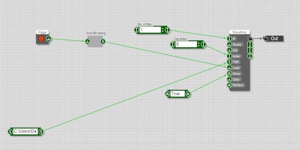

Why can i not load and play a wav file into this array?!
I have attached a picture showing my schematic.

Not sure, but we need to know what’s inside the “load file dialog” module, because you have a string output going into the Load trigger, but your Path to the wav is fixed in the string that starts C:\users\Da…
Usually the path is chosen by a load file dialog and when the path is chosen (in Windows) the path is supplied to the Path input pin and a trigger is created by the dialog to actually start the loading.
Providing a screenshot is fine, but adding the schematic would help more…

I somehow managed to get it working, sort of. It's actually the Vektor FSM with a lot if your stuff in Spogg.
Does anyone know where i can change the length of the wav sample? i loaded one with 1 sec length. But it sounds like its only playing i tiny bit of it.
