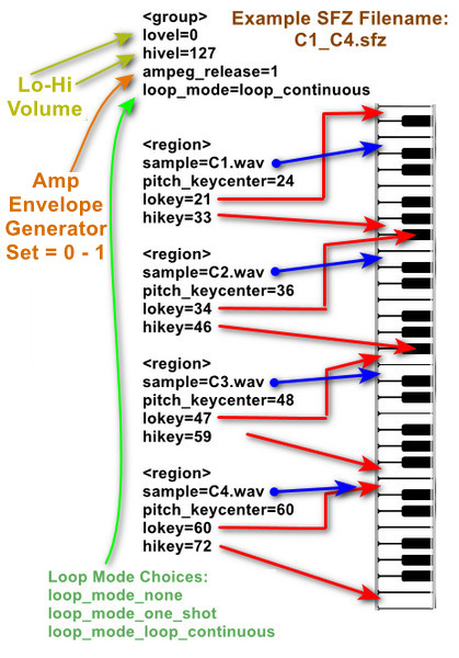

SEE 'WYSIWYG' SFZ FILE DIAGRAM IMAGE BELOW FOR EASIER
UNDERSTANDING: "A PICTURE PAINTS A MILLION SONGS"
- diaimgsfz.jpg (86.19 KiB) Viewed 23482 times
