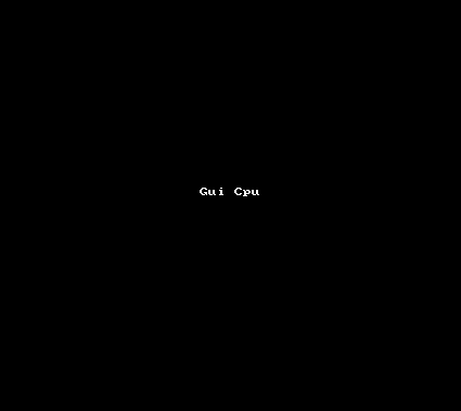

Postby lalalandsynth » Sat Oct 06, 2018 1:27 pm
So, the project reached 14% cpu, I shut it down, open the one without png GUI.
Its then about 3% and occasionally jumps to 5%.
Open the same project with the GUI and its anywhere from 7% to 12%.
Why is this ?
Like I said , most of my projects sit at 14-16% and I cannot figure out why .
Png issue.gif (693.98 KiB) Viewed 14708 times
