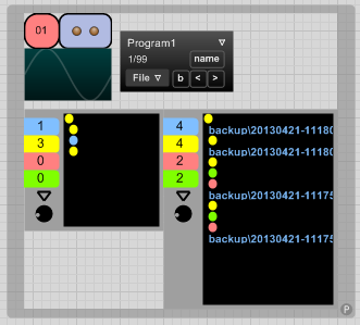

Weird - I just tried it here, following your instructions exactly, and it seems to work perfectly - even when I make an effort to try and confuse it, I get a backup saved every time, using either the buttons or loading a new shape.
No audio running though - I wonder if that makes a difference, though I can't think why it should.

Not working here, tested on two separate machines. I played with the schematic in the state as attached above. When I load a shape via dialog box (left led) - the background savig goes dead. See the picture; even the control triggers are not sent from preset. The only difference between left and right led (because both load external shape files) is, that with left led, in order to load a shape - you must confirm the load via windows gui dialog box (and this confirmation - not the dialog box itself - seems to cause the problem).
I will try another tiny thing here - the one that MyCo does not likes so much - time based separation between string update and saving trigger (interactivity emulation; instead of JohnA and JohnB - John and Nick, so to speak). Otherwise - no ideas.
//update:
With delay - not working. Even more - timer seems to be dependent on windows dialog box (i.e. in such case - background saving stops working also when left led is just clicked).
Trog - what your tools are showing on your computer?
//update:
