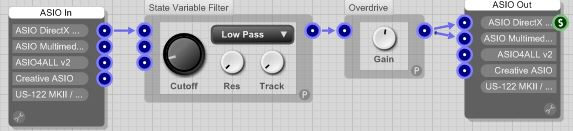

Grant, depending on just how distorted the signal is to be, If it is really distorted, then I am not sure that one would even much notice whether its a Germanium or not emulation. What will make a huge difference however, is the filters and how the signal is treated going into the non linear processing.
If it is to be a slight variation, in other words, not distorted beyond belief, then maybe, just maybe you would notice the difference between a germanium model and a 12ax7 for example. In any case, I would concentrate more on the filter design than anything else. A bad/inappropriate filter design will cause a user to dismiss your work before the distortion will..
If you want to create a fuzz box, you can start here with this idea.
To do:
Add some type of EQ after the overdrive component
Experiment with the cutoff values and filter types.
Add a master volume control
Open the overdrive knob and change it's max from 1 to 1000. This is what will give you enough distortion, but just make sure you add a master volume control or get ready to blow your speakers...
Thats a Fuzz Box type distortion.
