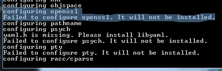

Well i noticed that when I compiled
When it came to installing openssl, it just said failed! I cant remember if it gave a reason. . .
Am I doing this correctly? To say that the "$LOAD_PATH. . . " line tells Ruby to look into that folder for files too?
c:\ruby-build> nmake

Yeah it compiled fine, just not with the openssl libs.
