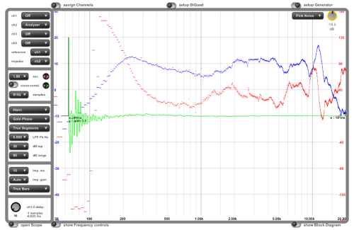

Here is a minor upgrade embedding the changes you advised, plus a new "open Scope" button at the bottom displaying the time-domain signals. Currently I'm only using such modality when sending a Dirac pulse, otherwise Flowstone crashes because of CPU overload when drawing lots of lines on screen.
The screenshot is the transfer function of a Logitech z120 speaker.
I'm perplex seeing the huge delay counting in thousands of samples between ch1 setup as "Gen" and ch2 setup as "Right-In". I can understand there is a delay because "Gen" is in digital domain, and "Right-In" is delayed by the USB link, sound card DAC, sound card ADC, and USB link again (actually, I'm using an USB audio card). However, a delay close to 10,000 samples looks insane to me.
As soon as the CPU gets loaded (say 30% CPU usage), the ch1 to ch2 delay appears to vary somewhat in a random way. This happens with the Scope being triggered by the green central trigger "do_fft". Thus, the green Triggers are far from deterministic, far from realtime. Surely the scope gets triggered by the central "do_fft" trigger, but surely also, Windows and Flowstone Green machinery are taking a certain amount of time - quite random - to execute such synchronization. When looking at the ch1-ch2 waveforms, it appears that the random delay introduced by Windows + Flowstone Green is between 50 ms and 150 ms. Is this pathologic, or is this to be considered as normal?

- FFT-based Spectrum Meter and Audio Analyzer v1.03 (standalone).png (47.45 KiB) Viewed 11782 times
- Logitech Z120.jpg (7.42 KiB) Viewed 11782 times
