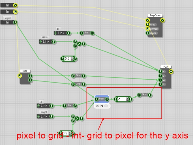

Sometimes I get blurry PNG graphics, In some cases deleting the Mgui and putting in a new one fixes the issue, sometimes plugging in a tiny value into the x/y fixes it. Apparently you would need to use a grid to pixel prim to alleviate this issue although I am not sure how.
Deleting the mgui will fix a static image but now I have a moving slider and at some positions its blurry.
I guess this is where the grid to pixel prim would be helpful but I dont know how to use it ?
Has anyone encountered this and can tell me how to avoid blurry graphics alltogther ?

Apparently this has to do with the graphics not syncing to the grid and can also happen if you have an image that is say , 33x49 and therefore hits "inbetween" pixels , but I am still unsure as to how to fix this , I even tried a different size image. Lets say you have this image 33x49 and center it in the frame it would be 16.5* 24.5 on each side so it makes sense , but after moving the image from center to the left side and removing the centering it still happens.
There must be something I am missing here , I guess what would need to happen is for the image to move in pixel increments, which it might be doing, I am not sure.
What is confusing is that the image is sometimes crisp during the vertical travel, but that might be an artifact of it changing as its always hitting those subpixels, although ,intuitively I would think that it would always be just as blurry throughout the whole travel ?
I feel like I have tried everything , maybe I have been unsuccessful in centering it properly , not sure.

This is maybe not directly addressing your issue, but I recently found (using Knobman) that you must only ever have an even number of pixels for vertical and horizontal sizes. Even though a 35x35 knob image looks good in Knobman, it’s blurred in FS. Change it to 36x36 and it's sharp.

Yes, having even proportions will solve this but not always possible.
Thing is , If you have non even proportions and force it to center you will "split" the pixels.
So, you can place it to the left in the window, that can solve it for a static image or a switch for example.
Sometimes , deleting the MGui and replacing it with a new one will fix an issue with a static image.
This applies when the image is crisp in the root but goes blurry as you move up one level.
As for vertical travel if you put this in between the y axis then it will be perfect during the travel .
Thanks to adam and tula for the help solving this.

I am still having a hell of a time dealing with this , fonts from photoshop always look blurry.
what is so perplexing to me is that it looks fine on one level and then a level up its blurry.
I eventually won this particular battle by deleting the mgui and inserting a new one.

perhaps with this in mind, could not a selector and some triggers sent automatically refresh the drawing as it were, if the MGUI were set to say, connect via selector/multiplexer onload, prompted by window open boolean?
I have not tested it, but it seems maybe workable.

check out the png in My latest fork of freq, in photoshop I scaled the image up. It's actually about 400 pixels wider than what is displayed. This method seems to get around this issue.
