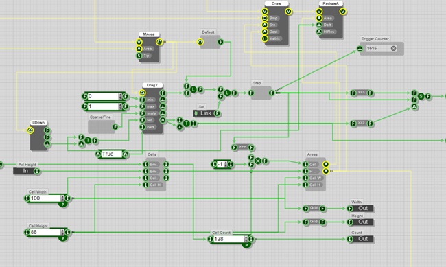

Here is my knob so what I would want to do is to limit the redraw triggers right? Where that trigger counter is.
Feels like i need to reduce the triggers somewhere before that right ?
I can put a change in front of that Step module and that works but will not update the value when I use Ctrl Click to reset the knob.
