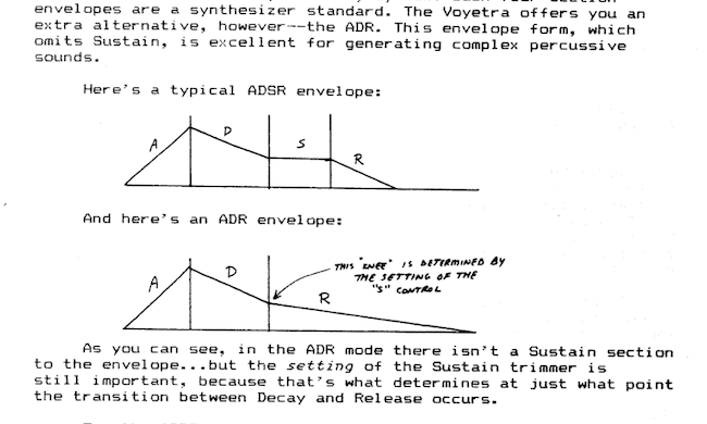

Anyone have any Idea how to get an envelope to function like this?
This is from the Voyetra 8 manual.
I'm toying with doing an emulation of the V8 and would love to include this unique ADSR/ADR envelope.

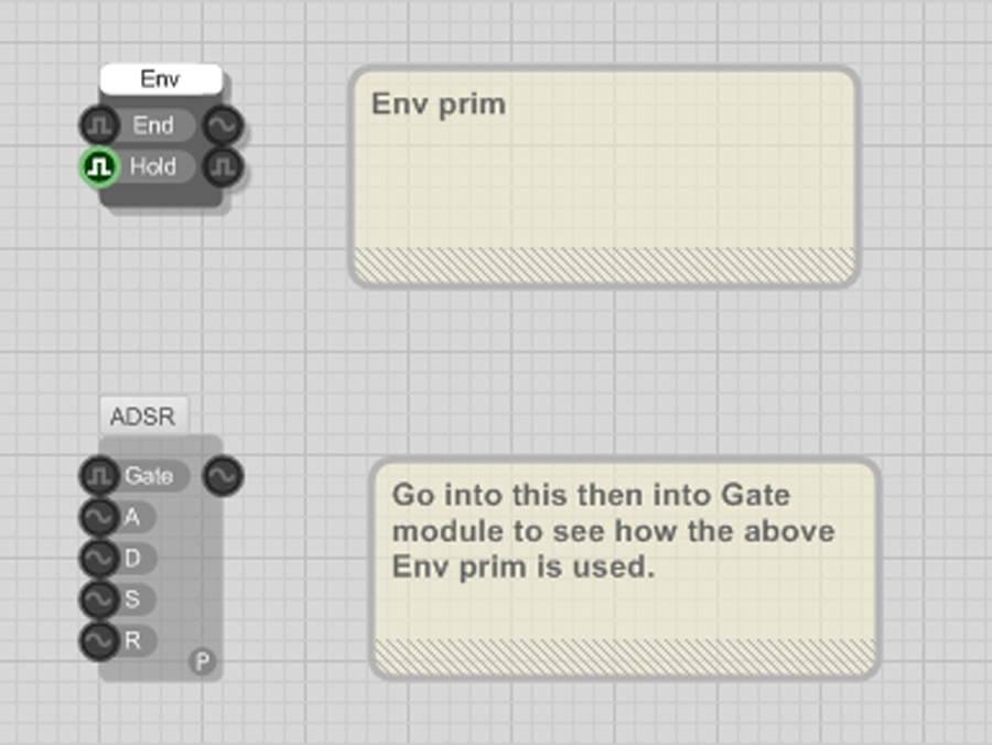

Re: Interesting envelope
The Env prim is for envelope control (poly only).
Hopefully this will help clarify but it's explained more in the Component Reference.
Envelope prim .fsm- (18.42 KiB) Downloaded 861 times

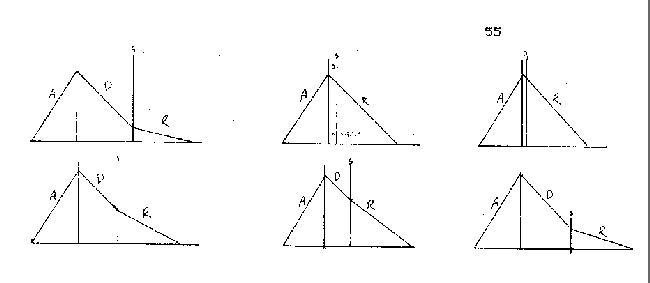

Thanks tula for figuring all that out, however a crucial piece is missing. The Voyetra ADR envelope still has a Sustain control - it sets the level at which the Decay portion of the envelope switches to the Release stage; it doesn't just eliminate the Sustain. I guess a more accurate name for it would be AD(S)R. Read the text carefully and study the two diagrams. In other words there is still a Sustain level that's set, it's just that the env doesn't stay at that level as long as a note is held but proceeds immediately to the Release stage as soon as the Sustain level is reached.
It looks like your code changes would result in the Sustain control having no function.
Here are some images from the manual that show several ADR shapes that differ ONLY in their Sustain settings.
k brown wrote:Thanks tula for figuring all that out, however a crucial piece is missing. The Voyetra ADR envelope still has a Sustain control - it sets the level at which the Decay portion of the envelope switches to the Release stage; it doesn't just eliminate the Sustain. I guess a more accurate name for it would be AD(S)R. Read the text carefully and study the two diagrams. In other words there is still a Sustain level that's set, it's just that the env doesn't stay at that level as long as a note is held but proceeds immediately to the Release stage as soon as the Sustain level is reached.
Did you even try it? If you follow it to where I wrote "This will get rid of sustaining", you will see that it works exactly that way! Decay of course goes to sustain level, then it immediately releases.
But hey, why bothering. Let's just ignore me and let Spogg do my work a second time
