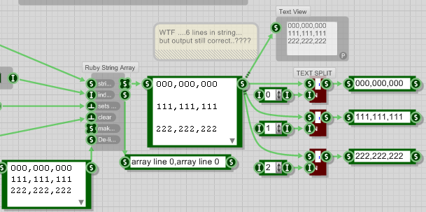

I found the bug in the preset system I installed in my synth.
String array prim's were not updating...
For arrays like the matrix and tempo modules(no comma's),
its not a problem as i can route output array back in the input array.
But the rest of the synth needed a solution.
So i built a "Ruby string array" that could handle feeding back a de-limited array..
End result seems to work perfectly
....but why this behaviour...???
Is it a bug...
EDIT: Fsm re-uploaded with trog fix...and properties adjustment(filename+folder)
Is it a bug...

Nope, it works rather correct. At least without looking into schematic I would say that, because I had today similar issue in greens. My guess is here this. Additional empty line at the end of array (it exists because empty line is also a beginning of modules like "text") is used by string processing as "line with null content" while in int/float processing - because it is a last line - it is not feed by zero and it is ignored. I guess that ruby and greens see this thing just differently.

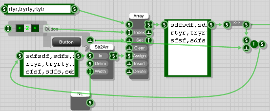

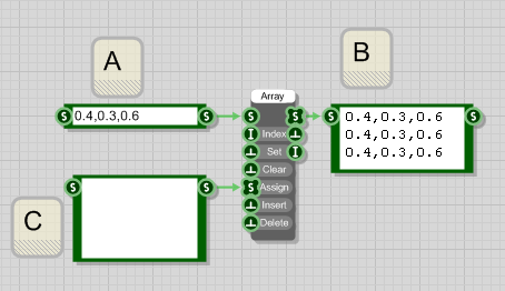

trogluddite wrote:That's why I suggested to check whether the problem was due to the old SM string array proble
The problem is the way I've put every preset value into a slot(comma's).
The FS String array does not deliver here...
If I input strings like 'A'....'B cannot be routed back into 'C' so the array updates...

Ah yes - see what you mean now, can't change the default delimiters - I always miss the obvious stuff!

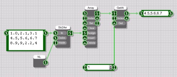

You can do it using the "String to string array" and "New Line" primitives - I think even with that extra stage, it would be faster than the Ruby, certainly for all the other more commonly used inputs.
Re: Ruby String Array
trogluddite wrote:You can do it using the "String to string array" and "New Line" primitives
Awesome...
