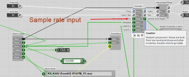

Postby lalalandsynth » Thu May 16, 2019 1:00 am
I am thinking if I could use this to pitch/stretch the sample according to bpm.
From the sampler in the earlier post.

There is a very simple time-stretch/pitch-shift algorithm in my old SK1 sampler that you can find in this post which might be worth a look. The timestretch player consists of just two modules inside the "-> Player -> Stretch Player" module of the schematic.
It doesn't save or load samples, as it's designed to capture mono samples in real-time from an audio input, but its sample input is just a regular mem link, so it should be adaptable for loaded samples quite easily. Pitch and playback speed are independent of each other, where a setting of one is the original pitch or playback speed - dividing the desired BPM by the original BPM should give you the correct value for the playback speed. The 'window' setting determines the size of 'grains' that the sample is effectively chopped into; shorter tends to work better for percussive sounds, and longer for pitched sounds; but in any case, the quality of stretching is very basic, as ideally the grain size should be matched to the incoming pitch.
