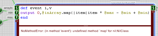

billv wrote:I'm having trouble getting control of min/max ranges for the Draw wave......
would be another cool oneliner in ruby:
#inputs: @arrayIn, @min, @max
output 0, @inArray.map!{|item|[[item,@min].max,@max].min}
#do anything with item between |item|......}
note here you just limit the values to max and min!
there you would change the range:
output 0, @inArray.map!{|item|item*@max-@min+@min}
also note, when you directly return the modified arrayvalues, you need to use the "!" after map, in this case the original array was modified (destructive)
if you put the modified values into a new array u can use just "map" with out the "!" so the original array stays untouched

Thanks nubeat7....but i keep getting method error for map!...
changing code from '@inArray.map!' ...to. '@arrayIn.map!' didn't work also...

Nubeat7 wrote:you don`t need event..
Yeh..it goes...i figure the error was using string array input instead of float array?
...controlling min/max either side of draw module is not a issue for this circuit....
Need to control the draw module min/max parameters directly...
I don't think this mod can happen otherwise ...
