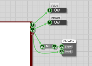

why not using the show cursor primitive? you can set "hold position while dragging"
Nubeat7 - Posts: 1347
- Location: Vienna
Re: MouseCursor Position
Nubeat7 wrote: "hold position
Thanks Nubeat7....didn't notice that...
