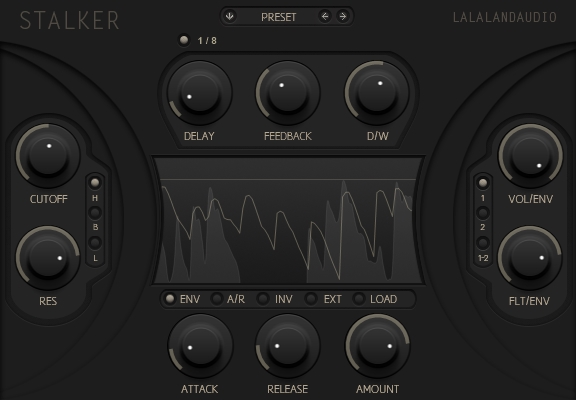

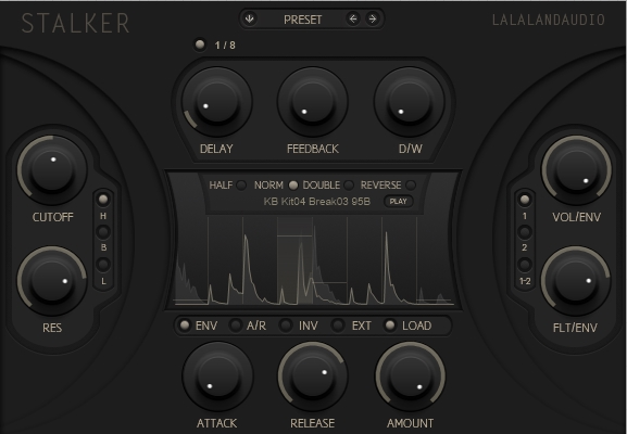

Postby lalalandsynth » Mon May 20, 2019 6:55 pm
Stalker . 2x Envelope follower to control volume or filter with sidechain input or wavefile load.
Also has , (which is lots of fun) a delay on the sidechain or wavefile /Modulator to make syncopated pattern for the modulation.
So..
Sidechain and wavefile has a sensitivity setting (essentially a gate) to drive the envelope follower/AR.
Then that gated file from the waveplayer or sidechain goes into the envelope follower and there you can set the Attack and release OR alternatively you can use the sidechain/wavefile to trigger an AR .
The input signal , whether its Sidechain or Wavefile has a delay for syncopated envelope or AR signal. GRoovy !
Its also possible to invert the envelope or AR.
The wavefile is auto tempo synced , with reverse and you can control the volume of each slice .
Pretty proud of that implementation , -----Also have the option to randomize the position of the slices but not done yet. In this demo its set to eight slices.
And to top it of , its a dual unit so you can load one wavefile into slot 1 and control filter and another into slot 2 and control volume or even also filter.

Postby lalalandsynth » Wed May 22, 2019 2:56 pm
Stalker Envelope Follower
Stalker ENV.jpg (83.76 KiB) Viewed 14304 times
Stalker Loop player
Stalker Wave.jpg (88.98 KiB) Viewed 14304 times

Postby wlangfor@uoguelph.ca » Wed May 22, 2019 3:21 pm
I just noticed the volume in the knob slick. Had You thought of having a full circle behind it that 20% opaque with a dull gray with a hint of green? It would make it look like something 3d rather than a concept. I say so because everything else is, but then again it's a nice contradiction?
My youtube channel: DSPplug
Posts: 912
Re: Stalker.
Postby lalalandsynth » Wed May 22, 2019 6:45 pm
Good idea, that might work , let me test
