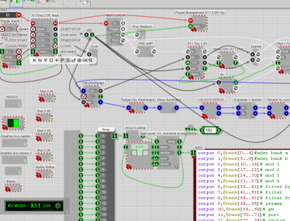

I've never seen 'a ruby companant shutdown' happen this bad....
While inside main fsm, i added a bad loop...
about 80% of all ruby componants in entire fsm were turned off for excessive processing.
Thought I'd mention it in case there were more noobs out there playing with loops..
Practice loops in isolation....

A "global" reset for the Ruby prim's would be nice though. If you know what bit of code just made the problem, it's often very quick to fix, but going through all of the modules to reset them is really time-consuming.
Re: bad Loop causes massive ruby shutdown
trogluddite wrote:going through all of the modules to reset them is really time-consuming.
they were all frozen...couldn't re-open...
brought in new ruby module and tried to capture offending code for reference...froze as well..
I think maybe if i removed all module links..may have unfozen it...
but didn't try...schematic too big...just bailed out...
should have saved it under alt name to re-investigate....

Yeah - it's really a mess - even if u only have 70 rubies in ur schematic
