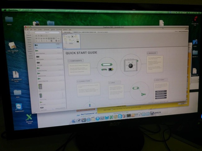

So this Pic will get you up - and NO - this is no fake!!!
This is FlowStone Free runing on an OSX 10.8.5 powered with Winebottler:
(App gets arround 700mb :P)
Well - I have to say - it run for eaven 10 seconds before it crashed ^^

I think i just got some settings wrong that are forced in WineTrick - WineTrick lets you Import libs from Windows example MS-Framework - some dialogs - AND GDX+ (called gdxplus)
I found out that FlowStone will Need GDX+ and the standart Windows Fonts otherwise the Programm Looks like a cutted peace of paper.
