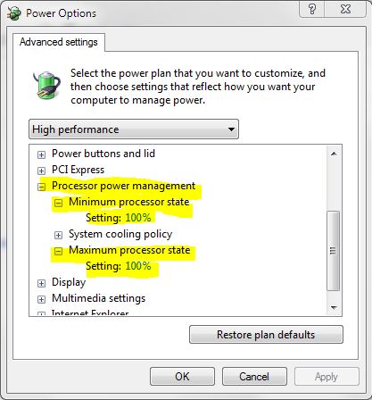

nix, I believe that you have it already check this,
but if you have not already done so you could see a parameter that is in power option preferences,
inherent to the CPU,
which sets the percentage of power that will have to be at minimum and at maximum load.
This parameter on some machines disturbs the processes audio
and you have many drop when the processor changes its power,
so set it to 100% for minimum and maximum.
and you can verify this by using this utility.
http://www.thesycon.de/deu/latency_check.shtml

Cheers Tronic!
Have just checked that now,
looks like they were already set right,
but flicking it onto high performance has helped for sure.
Very handy hint.
