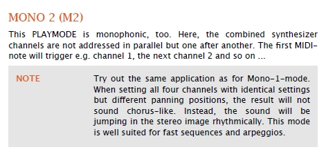

Point being - I'm just finishing up project based on the Vemona PERfourMER II hardware synth, which is, at it's core, four complete single-osc synths (that Vermona calls 'channels') in one box. It has a couple of ways of responding to MIDI Channels that I get how they work, but no real clue how to implement them with FS. It has six so-called PlayModes -
Mono 1 - All channels heard together on each keypress. Nothing unusual here, with FS, can be mono or polyphonic.
Mono 2 - (This I've no idea how to do) Each keypress sounds each synth channel in turn.
I've read the various MIDI prim hover-over texts and - umm, I dunno

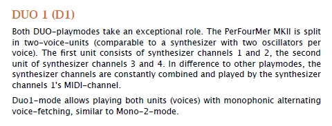

Duo 1 - Like Mono 2, but two channels heard with every other keypress.

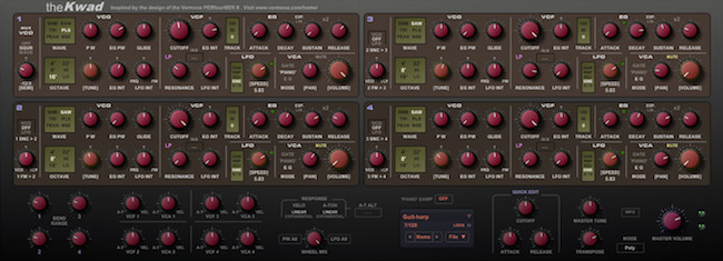

Here's what it's looking like -
Sounding pretty great, too - still working on presets. It even does up to four-op FM with each operator having multiple waveforms, a dedicated LFO and Multimode filter.

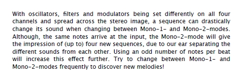

I think that these may be way off, too; in fact, I don't think the MIDI channel has anything to do with it at all. To be fair, though, whoever wrote that synth's user guide is using "channels" to describe something more like what we'd normally call "voices"; which seems like a dumb thing to do on a synth which also has MIDI!
If I read it right, on the original synth, "Mode1" is what we'd normally call "mono unison" - all four voices/"channels" play the same single note. "Mode 2" is what we'd normally call "4-voice polyphonic" - but with the unusual quality that each voice gets to have its own settings. Each time you play a new note, it is assigned to a voice/"channel" with different settings than the other three, so each new note has its own "patch" selected from the four.
