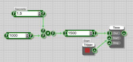

Postby Morph » Thu Feb 23, 2012 9:57 pm
Hi,
Using the Timer primitive:
BTW i wonder where is the Counter primitive in FS2?

Postby bflynn » Thu Feb 23, 2012 11:35 pm
Thanks Morph!!! Thats way better than the one i came up with!! I'll give it a try tomorrow and let ya know.

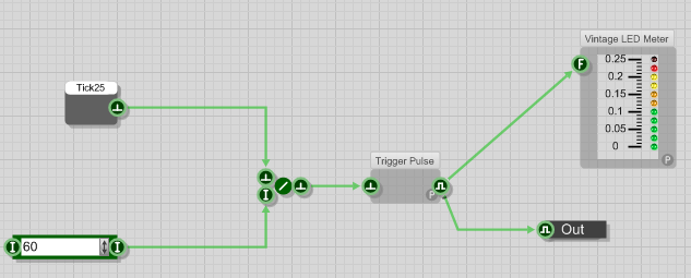

Postby DSP » Fri Feb 24, 2012 6:47 pm
This is even simpler:
Both this and the one from Morph use the Windows Timers, which are not very accurate but fine for display etc.
If you want it to be super accurate you can make one using the Ruby module, this uses a different more accurate timers.

Postby bflynn » Mon Feb 27, 2012 3:19 pm
Thanks guys. This is what I came up with. This gets me the output i needed. A continuous cycle.
