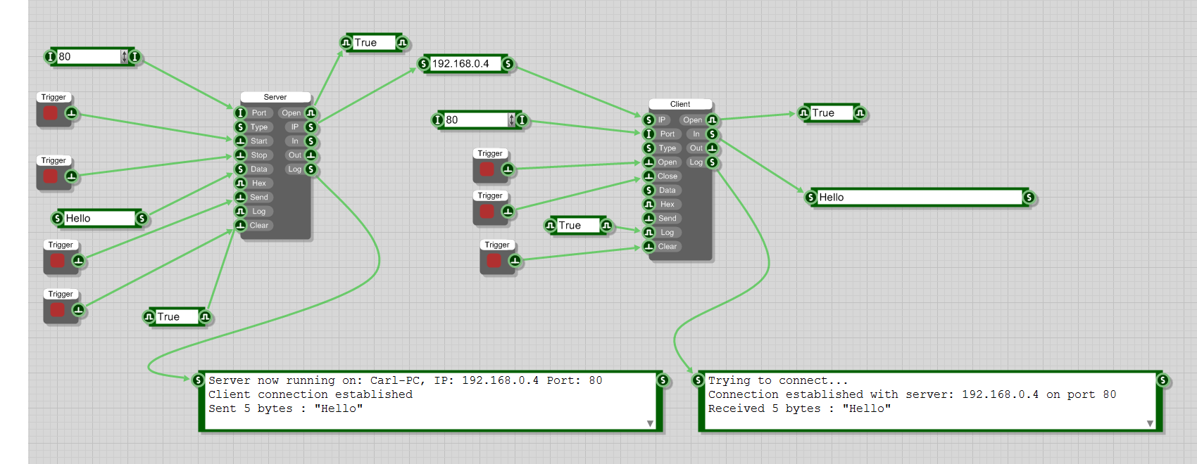

If it can't connect then the port could be blocked or being used by something else?
Try some different port numbers (eg. 1000), this works here but you may have to open the port in your router.
Does the Server start ok (must be started first)?
Here's what it looks like here :
- New Network Test clip.png (143.95 KiB) Viewed 31844 times

I think that's ok. Its the sender's port. The server will send it's answer back to this portqqwy wrote: The Server seems to run fine, but the client doesn't open the specified port. Instead it opens some very high port (5520, 5521, etc), going up to the next port every time it is closed/started again, skipping any occupied ports.
I'm seeing that too. I think the socket is bound to the IP address rather than 127.0.0.1qqwy wrote: That is what happens when I'm using my own IP address(the address the server outputs) as the Client's input. Configuring the client to use IP's like 'localhost' or '127.0.0.1' don't work at all, giving me a 'Could not connect to server' error.
