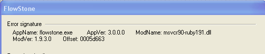

Flow stone 3 is crashing on start-up just like version 2.
Here's the error report- can anyone make sense of this??

I'm on XP. Flowstone 1 was ok. version 2 crashes the same way as version 3.
Tried that-no good.
So I then tried a 2nd CPU(laptop-XP) no good as well- and then I installed the
VC2008 redistributable, and Flowstone fired up all good.
Its running on my crappy old laptop-so you guys are in the clear, and I close the laptop.
I've got an issue somewhere on my main CPU......so i start fresh...
I deleted every trace of flowstone(registry/docs&settings-everything) and I removed
the VC2008 redistributable, I tried a fresh install of both.
Still no good.
Not much time to troubleshoot unfortunatly.
I am seeing some issues with my Firewall- probably got a bug or two somewhere-
will run some anti-virus and malware over the next week and see what's going on.
Any more ideas......thanks

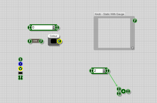

Not sure it this helps but, after startup and the error pop-up comes, flowstones interface
does all load up. if you drag the error screen out of the way, there's this
This is supposed to be the example file yes?
I saved it, just in case it may help

The screenshot you posted is indeed the example schematic but of course none of the Ruby drawing is working there hence the reason it all looks a bit odd.
