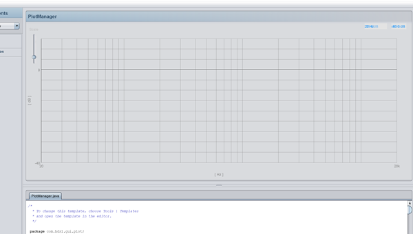

Regarding BODE diagram, I have lately converted the Sun's old SwingX GUI demo for Java to a generic platform that is to be used for this and that various application. A brilliant piece of software since all the SwingX tricks (elegant animation etcetc) are there and the programmer can concentrate on the app core features.
This process incudes a current development of a BODE plot as seen in the picture, and just now scaling of Y and X axis is being added (See the slider that will do that on Y). On the X axis I plan to create discrete options for displayed frequency range, like SUBWOOFER, WOOFER, MIDRANGE, ALL and perhaps more.
As you might spot, this generic application has a handle for dividing the screen and when it is dragged, the BODE is zoomed vertically. So, there could be frequency in the upper window, phase or legend info in the lower, or similar. Changing window content is a one button click operation in a left menu" window not shown.

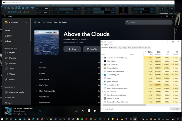

ON GUI EATING CPU. This notorious problem is given in example in the snapshot. I just developed that wide but not tall GUI to be able to have both that and some mediaplayer on screen simultaneously.
The only dynamic data is a couple of peakmeters, and yet, the CPU cost of that is almost 10% CPU, which I would suggest is currently a major obstacle for developing anything complex in GUI. I suggest it deserves its own thread, and that the original programmers are invited to join a discussion on how this problem could be removed.
The DSP of the shown app is less than 0.3% CPU on this i7 machine, so it IS the GUI grabbing the CPU.
Just a suggestion.

chjan wrote:The one and only major weakness I have experienced is the CPU consumption of GUI modules
This has long been my biggest complaint, and from many other people too, as far back as the SynthmMaker days. The primary problem is that no hardware acceleration is used - no matter how good your graphics-card is, all GUI rendering is done by the main CPU (using GDI+, an ancient Windows component). Making FS 64-bit and VST3 compatible has been the main focus of development recently, which is perfectly understandable and necessary, but I sincerely hope that the GUI bottleneck is the next major thing to get some attention - I have abandoned several projects because of it.
