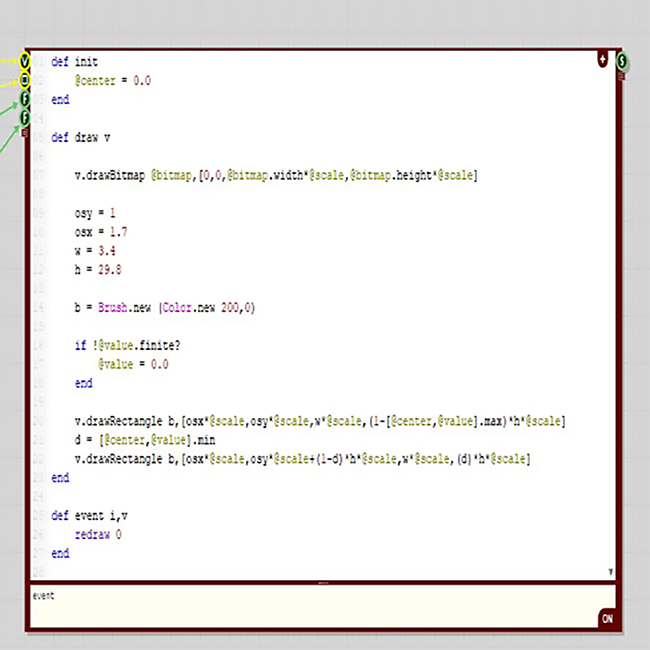

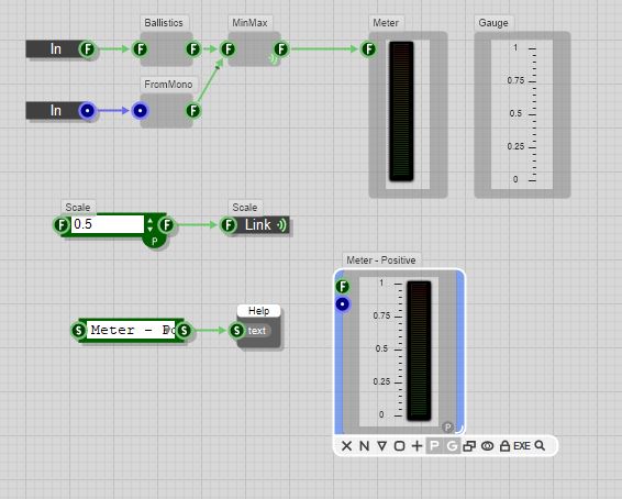

How to make the stock meter Db stay horizontal? Is it through Ruby settings? Which command lines do I have to change? Or is it impossible to do that?

Mr Duckett, I tried, I was changing and replacing values in Ruby and experimenting ... the meter almost became a spaceship and nothing to mark the movement horizontally ...

Of course a Ruby expert would simply re-jig the code, but it’s not so simple for most us.
So my “cheat” method is to use the Rotate View prim. This will rotate the view to any angle, as in the schematic. The tricky part is working out the 2 origins, so I use knobs to be quick and easy and then just set the values accordingly (because I like an easy life!).
The schematic also has a nice horizontal Vu meter (which is not mine) with a peak hold display.
