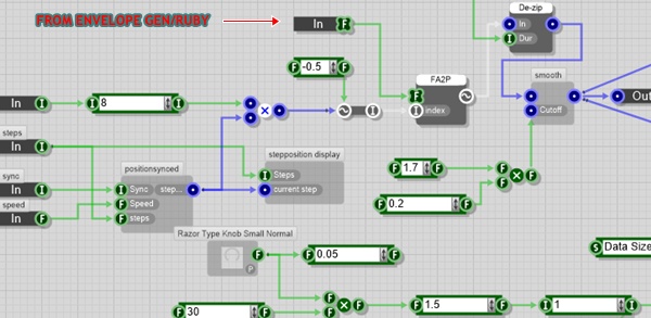

I don't know any Ruby but this is creating a 385 element float array. How are you using this array?
Since this is in green and generated by Ruby it may well be that the timing is too slow and inaccurate or it has insuffcient steps leading to quantisation artefacts. It depends on how you're using it. It won't be fast enough to modulate audio in real time.

@Spogg , yes , its coming from a float array and into a float array to poly.

You should be using some kind of interpolation to read values from the array. Linear interpolation should be fine.

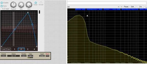

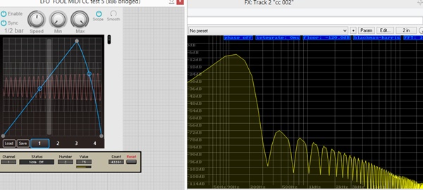

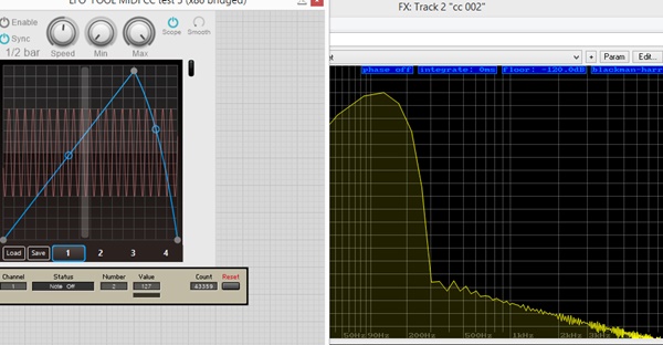

This is how it measures with the interpolation, still some obvious artifacts.
I can hear less artifacts then before though, so that is progress....I think?
Not a very fast envelope 1/2 bars
Disabled, Sine played through.
Enabled , Sine plus artifacts.

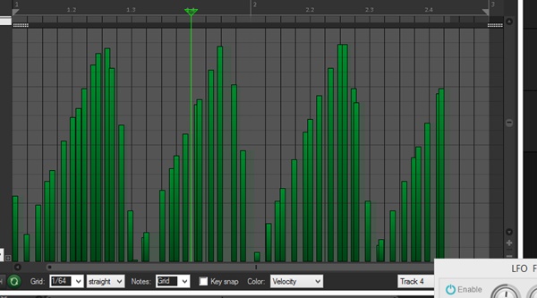

And still some pretty low resolution CC output, I am assuming that is the same issue.? It even looks a bit worse.

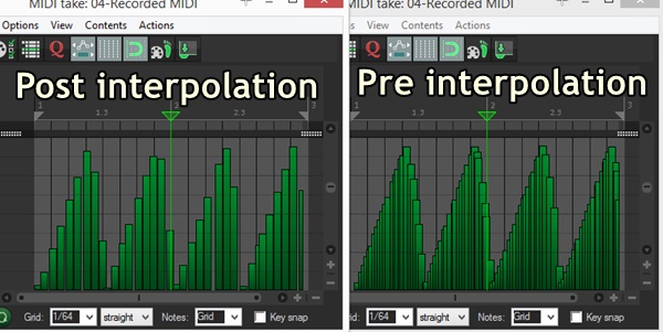

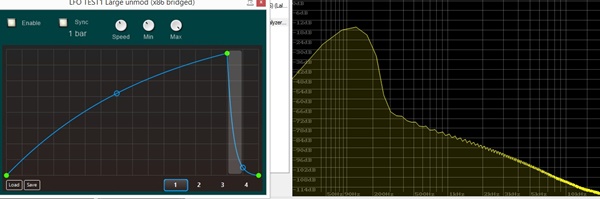

For some reason it sounds a bit better after the interpolation changes , (edit, after listening , it sounds far better, but still has artifacts) but it seems to be lower resolution , at least for the cc output ? Pre interpolation is much better for the cc ouput as far as i can tell, but still not good enough , should be much higher resolution and denser.
Also the audio looks cleaner before the interpolation, although I can clearly hear artifacts on both.
Before Interpolation - Sine - 1/2 Bar.
After Interpolation - Sine - 1/2 bar.
Not convinced that did the trick, can I increase the resolution of the interpolation or is there something else I can do ?

All you need to do now is get rid of the de-zipper from the interpolated version.
I've found that this prim doesn't work as expected if placed inline with a stream; you get crap. It's meant for de-zipping float to stream connections only, mainly for knobs.

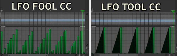

Still seem to have a problem with low resolution CC output .
I did a comparison with LFO tool , and it outputs hi res /dense CC.

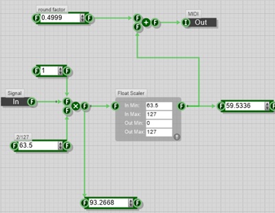

I do have to rescale the Midi CC , if I plug it into the envelope output it will output zero to max as 63-127.
So I plug it into a rescaler to make it go from 0 to 127
I wonder if the rescaling affects the resolution, although I doubt it ?
Do I need more ticks then 100 to achieve higher resolution ?
I am having a hard time finding any modules/synths in my library to see how this is done.
Project Attached.
