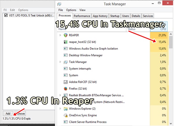

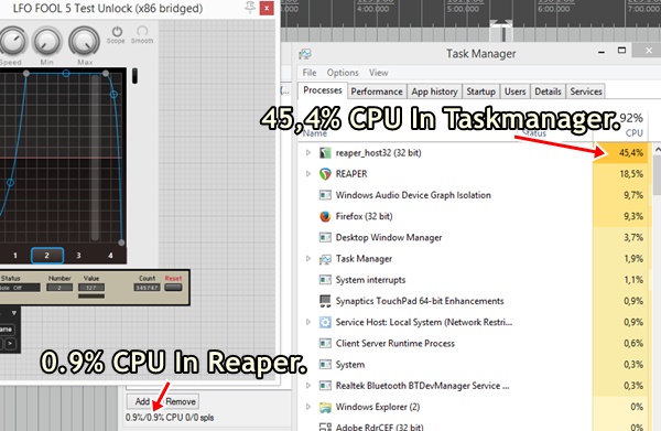

I am making a plugin that has a few moving graphics , a scope , running bar indicator etc.
It takes very little or about 1% cpu in FS but about 14% in Reaper , but only when the GUI is closed.
When GUI is open its about 40% !
I gather that the discrepancy between the CPU reported in Reaper and the actual CPU use is because it runs as another process due to the bridging ?
Is it normal to have a 1% CPU in FS and then up to 40% in Reaper , It seems reasonable that it takes a bigger hit as a VST but it seems excessive.

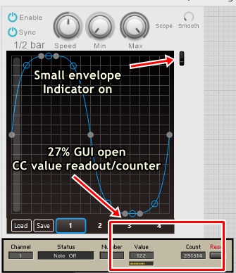

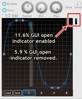

Ok, so I did some testing .
The test shows :
Testing most recent CPU hog version in Reaper - 40% with gui open -turning off the scope on the VST changes nothing, which is interesting because removing the scope from the FS project -exporting as VST has a significant effect. I wonder why that is ? In FS I shut off the input to the scope with a multiplex.
Removing the scope has the biggest effect ,admittedly I needed a scope with 8000 samples for it to be useful and in fact I would probably need more and its a dual scope pre and post,but interestingly I had 3 moving indicators and all of them had a large effect.
1. One tiny indicator (tiny scope used as an indicator) with 16 samples 100 ticks used as an indicator for the envelope movement.
2&3. An indicator/knob for the CC value ( not needed on the interface, just for testing) and a counter for the cc.
So... I tried a few variations for these indicators to see what was hogging CPU.
1.
Scope removed , midi cc indicator removed - small envelope indicator 11.6% with the gui open
Scope removed , midi cc indicator removed - small envelope indicator removed 5.9% with the gui open
So the CPU is halved by removing that indicator/Scope
2&3
Scope removed , midi cc indicator intact - small envelope indicator intact 27% with the gui open.
Again , CPU doubled by a small moving indicator.
Best results so far were obviously with Scope removed, CC value indicator removed and small envelope value indicator removed. This gave me a result of 6% CPU with the GUI open and 0.3% with the GUI closed.
I could get this down by removing the running position bar.
So I tried that .
Scope removed, CC value removed, small indicator removed, running bar removed. In fact , all moving graphics removed.
0.9% CPU with GUI open!
I was not too surprised that the Scope was hogging the cpu , but I have to admit that the two tiny indicators , one of them a scope and another a bmp , both seem very heavy on the cpu ?

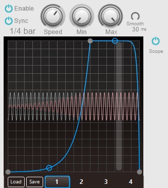

lalalandsynth - Posts: 600
Re: GUI + CPU.
Ok, so the scope seems to take a lot of cpu in other VST plugs as well so I guess it is hard to escape that but how can I make sure that it does not take cpu when turned off ? I have tried a selector on the audio input to the scope , on the Mgui and on the FFT Arrays . It always takes CPU until I remove it completely , is there a way to make this work assuming that I am cool with the cpu when it is on ?
AHHH ! Trigger limit seems to have done the trick. Now when I shut it off the CPU drops significantly, but not completely.
Still wondering if I can get rid of any more cpu cycles when it is shut off on the VST ?
Re: GUI + CPU.
That scope that you are using has a trigger switch inside that controls if the triggers of the Tick25 primitive go through to the Mono to Graph primitive, you can just connect a bool to this trigger switch.
But the real problem seems to be that the stepposition display is causing redraws on the line editor and the scope, because they occupy the same space. It helps to only draw the stepposition display when the step position has actually changed, and also to only redraw the affected area of a stepposition change.
Here is a modified version:
Step position display optimized.fsm- (1.13 KiB) Downloaded 959 times
