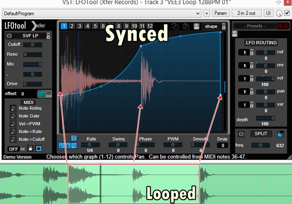

Here is how it works in LFO TOOL. Written in c++ , engaging the scope is cpu intensive.
The scope syncs in 1/4 bars or one beat which is very convenient when tweaking the envelopes.
When I push stop in the DAW , the waveform is held which is very nice. Gives you time to tweak the envelope and no cpu used and no audio running.Scope is only engaged for a short while and turned off 97% of the time.

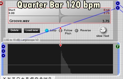

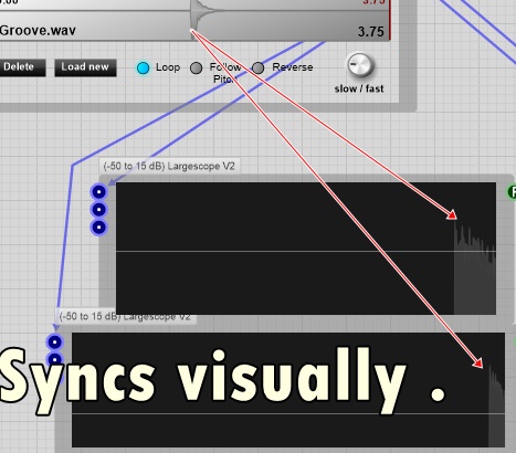

I am also thinking about a compressor with a waveform view and a superimposed gain reduction envelope,or an envelope follower which shows the rectified envelope and it visually syncs with what you hear although this is NOT the same thing as the SYNCED SCOPE but I would like to know if I can make the waveform start at the beginning of the window rather then start at the end of the window ?
It is done like this(see pic) on the Fabfilter Compressor and I found something similar and seems to work just fine , but yes, would like to know if I can offset to make the waveform start at the beginning of the window.
If I could do that , I could use this as a starting point "scope" for the Tempo synced scope although I would prefer the whole waveform and not just the positive going part ...if I am correct?

Hope I am making sense ? Essentially I would like to achieve this .

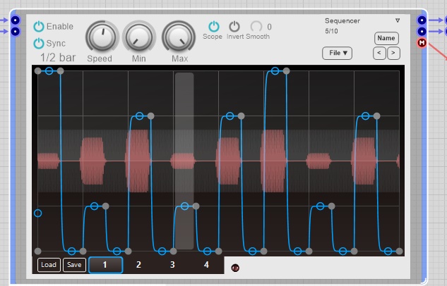

Take a look at the last post I posted, there I made a synced largescope. You have the option to select the amount of beats you want to enter in the window, by default it is 1.http://www.dsprobotics.com/support/viewtopic.php?f=2&t=6595&start=10#wrap
