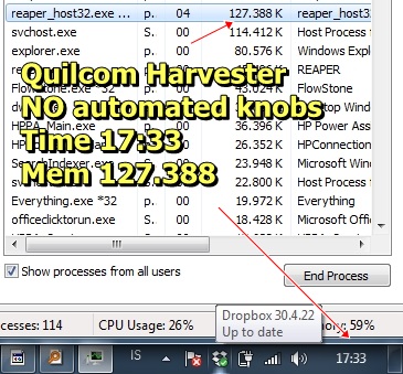

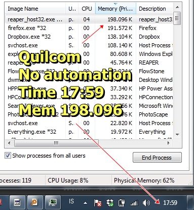

I ran Harvester for 26 minutes.
Quilcom - started .
Quilcom 1.jpg (77.91 KiB) Viewed 34582 times
Quilcom - after 26 minutes.
Quilcom 2.jpg (89.72 KiB) Viewed 34582 times

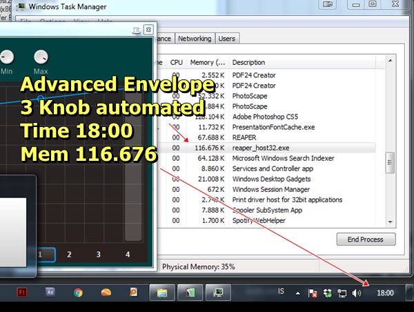

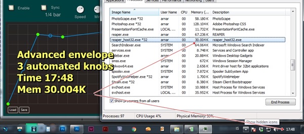

I also ran Advance envelope for 12 minutes
Advanced Envelope-Started.
Advance envelope test first.jpg (75.08 KiB) Viewed 34582 times
Advance envelope after
Advance envelope test 2.jpg (103.08 KiB) Viewed 34582 times

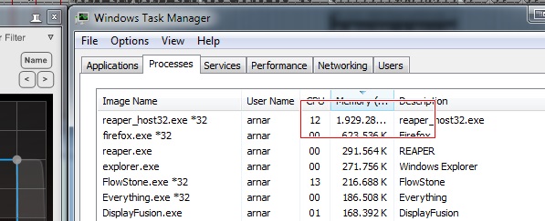

Postby lalalandsynth » Sat Jul 15, 2017 7:13 pm
My plugin that contains 2 advanced envelopes , 2 circular sequencers , and 2 synced lfo´s and a steady scope which all eat memory used alone will reach 1.5 gig in a typical production session of 20 minutes or so.
About 130-40 when opened.
Here is a gif
https://media.giphy.com/media/3ohrylfgE ... /giphy.gif
