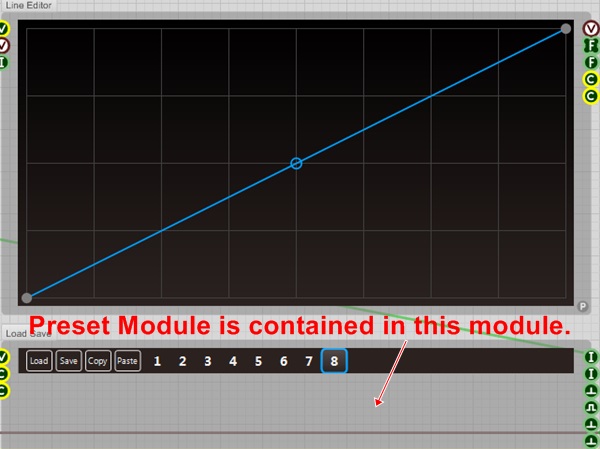

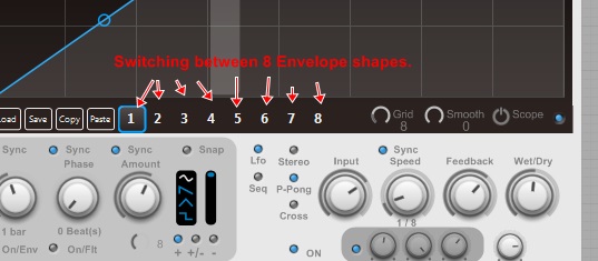

I am trying to automate the state selector for this advance envelope - switching between the 8 presets.
It is set to rec to and automate from host , shows up as a parameter in Reaper, but will not automate when I apply a curve and I cannot see why ?
Can anyone have a look at this and see if they spot the problem ?
The VST param for the state selector can be found in the save/load - 1-8 preset bar.

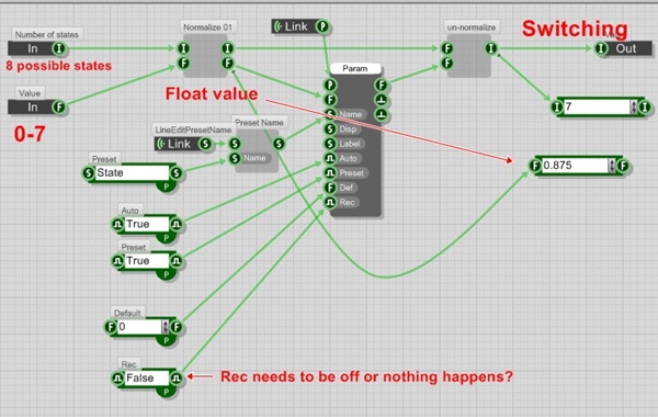

It seems to me like Automation Recording has to be turned off for host automation to work.
I also nomalized the values for the preset prim (I think preset values must be between 0 and 1).

Thanks ! This works
I wonder why it cannot be automated from the GUI itself -Rec ?
And why enabling rec -disables the automation ?

Automation means the DAW can control the knob.
Rec means you can record knob movements from the FS VST GUI into the DAW.
Normally both are set to True, so you can record a knob’s movement and, in playback, the knob will move and the parameters will change.
It doesn’t even need to be a preset so if you de-select Preset you can still manipulate the parameters in the DAW. Of course the naming must still be unique in the project and this configuration is unlikely to be of practical use in my view.
You can test this and if not correct please report back with a simple demo.
As per the Component Reference all preset parameters must be in the range 0-1. I once tested this and the parameters will store large float values BUT you lose accuracy when re-loading the presets. Also, I’m not sure that DAWs will correctly handle values outside of the 0-1 range for automation. I never checked this out.

I meant "test" as in implement it and understand how it is "normalized" , I have not encountered this before where I need to automate a 1-8 state or where I am switching between 8 values. I guess I somehow figured that the preset module would "convert" any values at the input into a float representative and "ignore" input values.
Problem number 1,
I am switching between 8 envelope shapes , using integers from 0-7.
This needed to be "normalized" or converted to float between 0-1.
Om's solution was to "normalize" the values to get float value to represent 0-7
This however requires the Rec to be disabled or it does not work to automate it.
Other then that this worked for the example posted which is just the basic advanced envelope , except that it has been changed to 8 possible shapes rather then 4.
