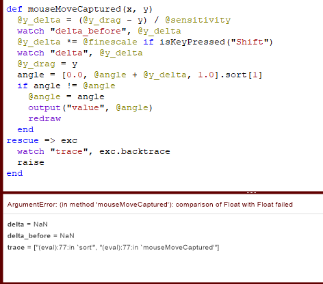

And here is an actual example of how rescue and the StandardError method :backtrace helped me to find a pesky, rare issue.
I used raise here to let you see the original error message I got. It made no sense. "Hey, in the mouseMoveMethod you tried to compare a float with a float!"
It also shows, what I forgot about in the first post. When having a method, you can add a rescue block at the end. The whole method definition then acts like a begin, rescue, end block.
Back to the error. In rescue I accessed the exception via local variable and called its method :backtrace. This is -simply spoken- like a raw version of the message, that was constructed. It gives me a litle bit more detail, as it tells me that actually the error is not in the method itself, but in the sort method, that I called in line 77! Now that I knew it must have been something that made the sort comparison impossible, I could check precisely for the objects used for sorting. Obviously 0.0 and 1.0 are valid, and for reasons I omit here, @angle was also valid all the time. So it could only be @y_delta. But I still didn't know why. So I placed some watch methods, to see the content of the object. In rare cases, @y_delta can become so small, that it can't be represented with a float anymore. It becomes undefined, and the description for that is NaN ("not a number"). Comparing any float with NaN is an unordered result and must therefore raise an exception in a sorting method. However, the designer of the message belonging to the ArgumentError did a bad job by just showing the classes. At that point @y_delta was already undefined, so it should have shown "comparison of NaN with Float failed". Since NaN is not a class, but a value in Ruby, it slipped through.
The solution is now very easy. The FloatClass has a method :nan?, which returns true if the value is NaN, and I just need to check for NaN (and replace it) before passing it to the sort algorithm.
