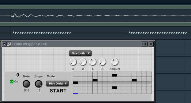

Re: accurate midi?
trogluddite wrote:a modules that locks to the phase of VST PPQ etc. ought to be possible
How are you going with this Trog?
My timing tests are not hitting 100% accuracy. Looks like it may be required.
- Posts: 1161
Re: accurate midi?
Solved.
viewtopic.php?f=3&t=1255
