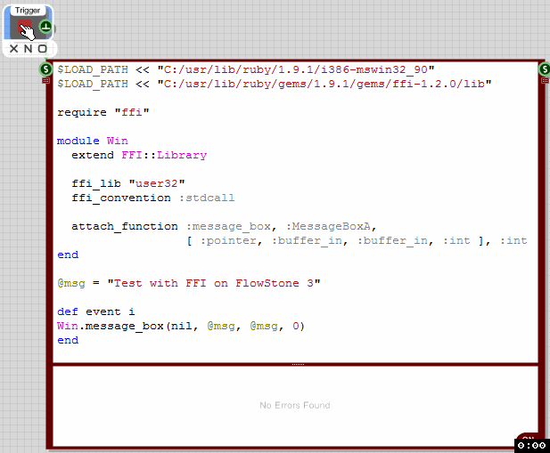

I managed to create a full version which also supports yaml and zlib,
so to have the ability to install gems (when package is ready, I try to put it online for download).
so now some tests:
installed the gem FFI, works really well,
but here FS3 after a while I get the message that you can see, (please click on image an wait) :shock:
now I wonder in the future it will be possible to disable this protection?
Otherwise, any process that is not executed within the time set will be judged to be locked,
but in reality the example is just waiting for you to press the ok button.
Malc there are tricks to be taken?
I hope this will work without ruby goes off.
Test with FFI on FlowStone 3.gif (626.87 KiB) Viewed 32332 times

Interesting experiment!
So if I understand right you're loading your own ruby dll instead of the msvcr90-ruby191.dll into flowstone?
Did you test what gets loaded if you run an exported exe or VST dll?
(An exported exe or dll has the ruby runtime included)
cheers for the hacking efforts!

Postby digitalwhitebyte » Tue Nov 27, 2012 12:45 am
No Hacking, but Implementation.
The ruby ​​interpreter used by Malc was compiled on windows platform compiler with Visual Studio 2008 I think,
so it is linking to msvcr90.dll runtime, this indicates it in the name of the library msvcr90-ruby191.dll.
So knowing this, I have compiled from Ruby binary for this runtime version,
and compiled the various libraries are essential to be able to install gems, yaml and zlib.
At this point I have a compiled version of Ruby, which is not based on mingw compiler, but on visual studio.
Now being based on the same runtime dependency, what will you implement in your compiled version of ruby,
gems, or otherwise, or existing libraries, can be used by the existing version of msvcr90-ruby191.dll in FS3,
without changing the DLL, but simply integrate libraries or gems, with commands
$ LOAD_PATH "My_Path / my_folder /" # pointing to it
require "my_lib" # include it.
making sure you give then to your exe or vst, the folder with the proper libraries added.
I managed to successfully implement a lot of things, but as the post above,
you should see if we can eliminate the auto-off of ruby code, otherwise some things will not be implemented.
I think the beauty of having ruby in FS3 is precisely this type of use.
Malc will tell us something soon as he can.

Postby support » Mon Dec 03, 2012 10:00 am
Sorry - must have missed this. Please do feel free to email us if you need a response or you think we've missed something. Use our support address at the top of this page.
There's quite alot to digest here. After a quick scan I'd say that what you're doing is indeed correct - well, it obviously works so that's as good a test as any! :)
Regarding the protection, you're right there are situations where you could be waiting for the Ruby thread to return but not be in an unrecoverable situation. We don't currently have a way to get round this but I can see it would be useful if we did. We will need to have a look into it.
Nice work btw.
