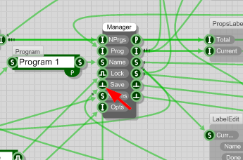

wouldnt it be enough to just trigger the save input of the pm primitive?just installed greenshot to make screenshots and easily put arrows and stuff on it

No...that works in FS....but in VST/Standalone mode....nothing is there on plug-in reload.
Its always been like that
. Very fustrating that the VST/standalone user can't use the
Preset manager just like we do in FS-save straight into slot..and it's there...
This VST/Standalone preset issue has led people(like me) to make "alternate" preset systems,
and you can see this in the last X11 Update, it's a very messy/ugly way to go about it.
I guess the file dialogs could be included, and bring back the option to save/load manually.
I'm still worried about the speed of it. And can only see 3 options to fix....
