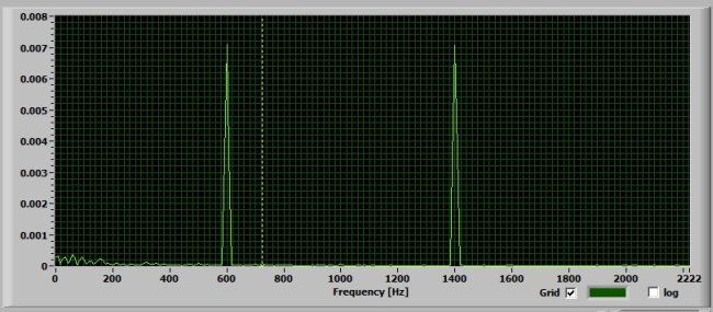

Ring Modulator addendum....
If you multiply two signals together in a ring modulator, you get the sum and difference of the two frequencies, with both carrier and program completely suppressed !
The demostrator comes with 1,000 Hz and 400 Hz. preset.
You can adjust the frequencies as well.
And the hookup is Dead Simple !
Here's a screenshot of the included schematic.
ROXY
ROXY
- Screenshot of 1,000 Hz. multiplied by 400 Hz. in a ring modulator
- Ring Mod. screenshot.jpg (139.46 KiB) Viewed 6848 times
