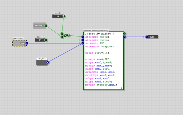

Re: Position Synced StepLFO
Postby lalalandsynth » Mon Oct 22, 2018 4:57 pm
"did you unwire the pseudo host inside the ppq sync module? there you need to connect the timesig from host and the host ppq primitive, i was using a pseudohost module for testing inside FS, forgot to unwire this"
What do I need to change for this to work , what can I connect instead of the Pseudo host , I am a bit confused by this ,will it not run without the pseudohost in FS ?
EDIT: I see, It runs in a daw when hooked up properly , just needs the pseudohost for running in FS.
lalalandsynth
Posts: 600
Postby Nubeat7 » Thu Dec 06, 2018 9:55 am
You are right, the pseudo host just imidates the playpositionmarker of a daw, it also is purgeable, so it will be deleted when you compile your project. Then, when be used as vst, it will use the ppm from host.
