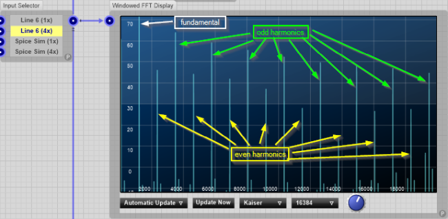

I am impressed with the optimization of the DSP code and converting it to assembler! The FFT Display clearly shows even harmonics and the oversampling removes odd harmonics as far as possible, although it increases the CPU load. And if the number of tube stages as in modern amplifiers is 4 or 5, won't the processor be overloaded?

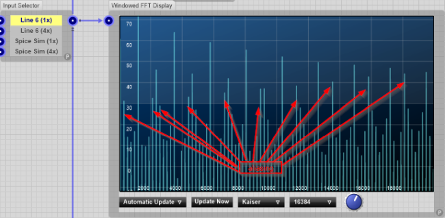

No, oversampling does not remove odd harmonics, it removes aliases. Play with the Frequency knob holding down the Shift key and watch the direction in which each of the peaks goes. Those that move backwards are aliases. You should also be able to hear it, especially those below the fundamental.Emil wrote:The FFT Display clearly shows even harmonics and the oversampling removes odd harmonics as far as possible
Here is a linear frequency plot:
The harmonics, whichever even or odd, are not affected by oversampling. The second image shows a multitude of frequencies in addition to the harmonic series. They are all aliases, the red arrows highlight the most prominent ones.
I don't think so. On my laptop readings are 1.5% for the non oversampled and 2.5% for the oversampled waveshaper. The increase is not necessarily proportional as you add more stages, and yes, the up- and downsamplers would probably be used only once, while everything in between would be oversampled. The details depend on what else you want to incorporate, but at this pont I would not be concerned about CPU load.Emil wrote:if the number of tube stages as in modern amplifiers is 4 or 5, won't the processor be overloaded?
