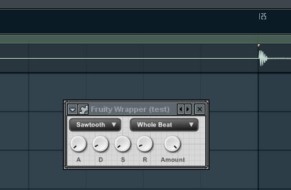

trogluddite wrote: PPQ Test 003.fsm
Tested in FL Studio. Great stuff Trog, but there's a small problem. She's dropping a few notes
here and there. These happen at regular timings, so there's your way in for the fix.
After about 5 min, your still right on the money, but the error still there
Your "Master Clock" theory sounds perfect. create it in one place and then distribute via ruby
through the schematic. Would also help to make FS "solid as a rock", and make it feel like it
was made out of cement.

Thanks Billy,
Think I have an idea what the problem might be - after more Reaoer testing, I have seen the same thing sometimes: seems to be if the ASIO buffer boundaries match the beat boundaries. I'm getting occasional double triggers in looped playback too.
Have an idea what I can do to fix it- i just need to store the last value from the previous buffer to paper over the cracks! Should have an update this evening.
