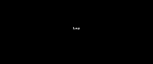

Re: Stock EQ V2
Postby lalalandsynth » Tue Nov 06, 2018 9:10 pm
This lag on the stock EQ had always bothered me , I wonder if it can be fixed ?
Really like the display , have not checked the sound yet :)

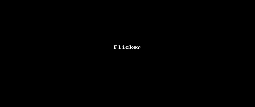

Re: Stock EQ V2
Postby lalalandsynth » Tue Nov 06, 2018 9:19 pm
Also there is some sort of flicker on the analyser , you can see it in this gif.
EDIT: Its actually hard to see on the gif , but its shows up there for a split second on the bottom half , its constant when running in FS.

Re: Stock EQ V2
Postby wlangfor@uoguelph.ca » Wed Nov 07, 2018 3:21 pm
Hmm, yes.
You know; in the tense of animation and lag - it is best to remove any instances of hotwiring. I have a feeling that the original
Synthmaker preferred straight math. But that issue had been from the beginning with KG's code. It's some anomaly that I
am not "in the know" of it's origin. I have noticed however; If the sound created is computed quickly with less delay; there is less of the effect. That would say to Me that the issue is a lack of a buffer. Could anyone be so kind as to point out a buffer for fft objects? It could be that I find something that can achieve this.
So, rather than "hotwiring" things; I've been using plain addition, subtraction and multiplication. I intend to go through the code meticulously and look for all tenses of this so that the code does not question itself.
The very fact that a hotwire can either subtract or multiply is a question. And if there are many many questions; Then, You and I realize there is less processor power available. The odd thing though is that hotwiring seems fast on the CPU; But start
and stop for visual elements.
