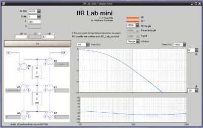

I'm attaching :
- a .fsm, with a few cosmetic changes, which is the one implementing the Ruby "True Averager", with your nicely commented Ruby code. This is very pedagogic. Thanks.
- a .jpg screenshot of IIR Lab mini, a little program I made using MS Visual Basic for calculating IIR filters. For duplicating your IIR lowpass, I have set a 44100 Hz as virtual sampling frequency (it should be 10 Hz, but the program doesn't allow such low value), a 1st-order, and a 360 Hz frequency. The "LP" coefficient must be set to 1, and the "HP" coefficient must be set to zero (this is a pure lowpass). On the schematic, you get all IIR coefficients properly displayed. Why 360 Hz here ? Because 44100 Hz multiplied by 0.0825 = 360 Hz roughly.
- a .zip containing the install files for IIR Lab mini.
Steph

I'm attaching :
Steph
