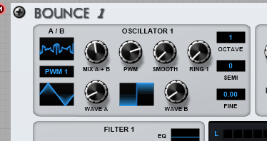

And inside this osc knobs. Its wierd to. Its 512 size there and end out in 256. Hmm i will check thoose osc knobs more to understand this. this is strange. Not uch make sense here.
It seem like ur trying to make a moprh? some how?
I have a morph in ruby working 100% + 4 diffrent pwm modes.
I did get help by nubeat for this module so i cant just give it out like this. If u ask nubeat about the morph and told him i sent you. Mybe u can have it. And do something.
But that thing works. 2 knobs for editing the waveform. And then PWM i will show u an image.
Hmm Mybe i dont need this tool
Mybe its better using that one O: This makes all u need
:D
But im not sure if nubeat wana give it out like that just.
Tlk with him mybe give him a little donation and he will give u
I also have a ruby keyboard form him u load BMP files and it works like the pro ones
hehe

Omg thnx spogg. Ye im on 3.06. Im not after using this in vsts (its to big) just making waveforms it can be very usefull.
If u ask nubeat my thing is much easier.
Im not very good with ruby. But u can prob connect 10 knobs to this ruby to. And u have output waveform u can save that makes the exact sound thats why. Ur 15 waves + PWM
cant get better to get what u want.
If its personal use also would be much easier to get nubeat agree this
Ok spogg i go ask nubeat if this is ok for him then check hes stuff. Its amazing thing.
Mix hes with urs and we have best waveform genereator.
And btw it doesent matter if there is some kind of little dist. I just thinking it would be good without because u can hear clearer what kind of sound ur producing. Before u save the waveform
