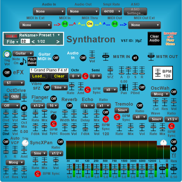

Designed for use with standard electric guitar it can be utilized with practically any form of audio source input.
The audio is first processed through a pitch extractor then converted to a midi mono signal. This allows a standard 'audio stream' to be used to control midi effects. Conversion can cause significant latency. Use of ASIO latency reduction software such as ASIO4ALL is advised.

Synthatron utilizes SFZ soundfonts for the SFZ1 VCA/VCF sampler (near top left). It may be necessary to 'load' an instrument soundfont at startup. Open/Load a soundfont fron the "pwemidisfzs" folder included in the zip file. Instrument soundfonts are in the main folder with ".sfz" file extension name.

guitar pitch to midi is my favourite dsp problem
edit- hey this sounds really good,
harmonics are barely reproduced
it has so many sound shapers!-- I am more interested in the pitch-detecting core though.
it tracks the whole 40-88 range

That looks like an old schematic of mine.
The MIDI conversion has lots of jitter beause it uses green along the way. Back then there was no other way to trigger MIDI events from a stream - today we have Ruby and the Mono-to-frame prim. With these, it should be possible to trigger MIDI from stream without jitter.

The pitch extractor is from a schematic in the synthmaker bundle "5575_GuitarSynth.fsm" … I believe it is Martin's. It was the best I could find. The inclusion of sfz sampler adds significant chatter. I would much prefer a ruby code mono to midi pitch trigger if someone knows of an improvement. Please simply post the script in a reply for assembly and test.
For audio I am using Yamaha AG03 with Steinberg ASIO channeled through Voicemeeter ... latency: 5-10ms ...
