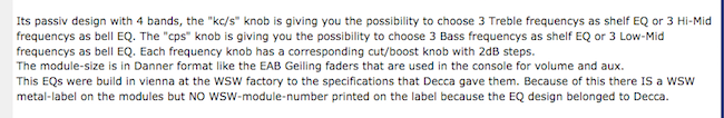

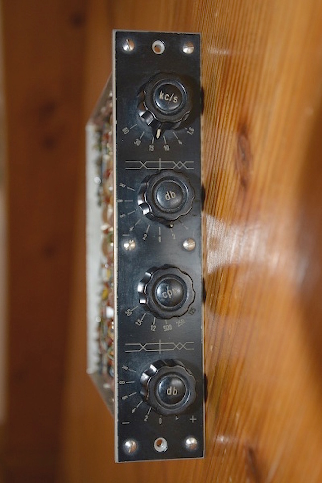

Gonna try to approximate this very cool EQ used by Decca in the Sofiensaal from Gotterdammerung on:

Anybody have a cool rotating text module I can use on the knobs?
Pretty exciting to think I can use this vintage Decca EQ concept on my own Classical recordings!

No, not curved text, but text on a knob that rotates with the knob (see pic).
