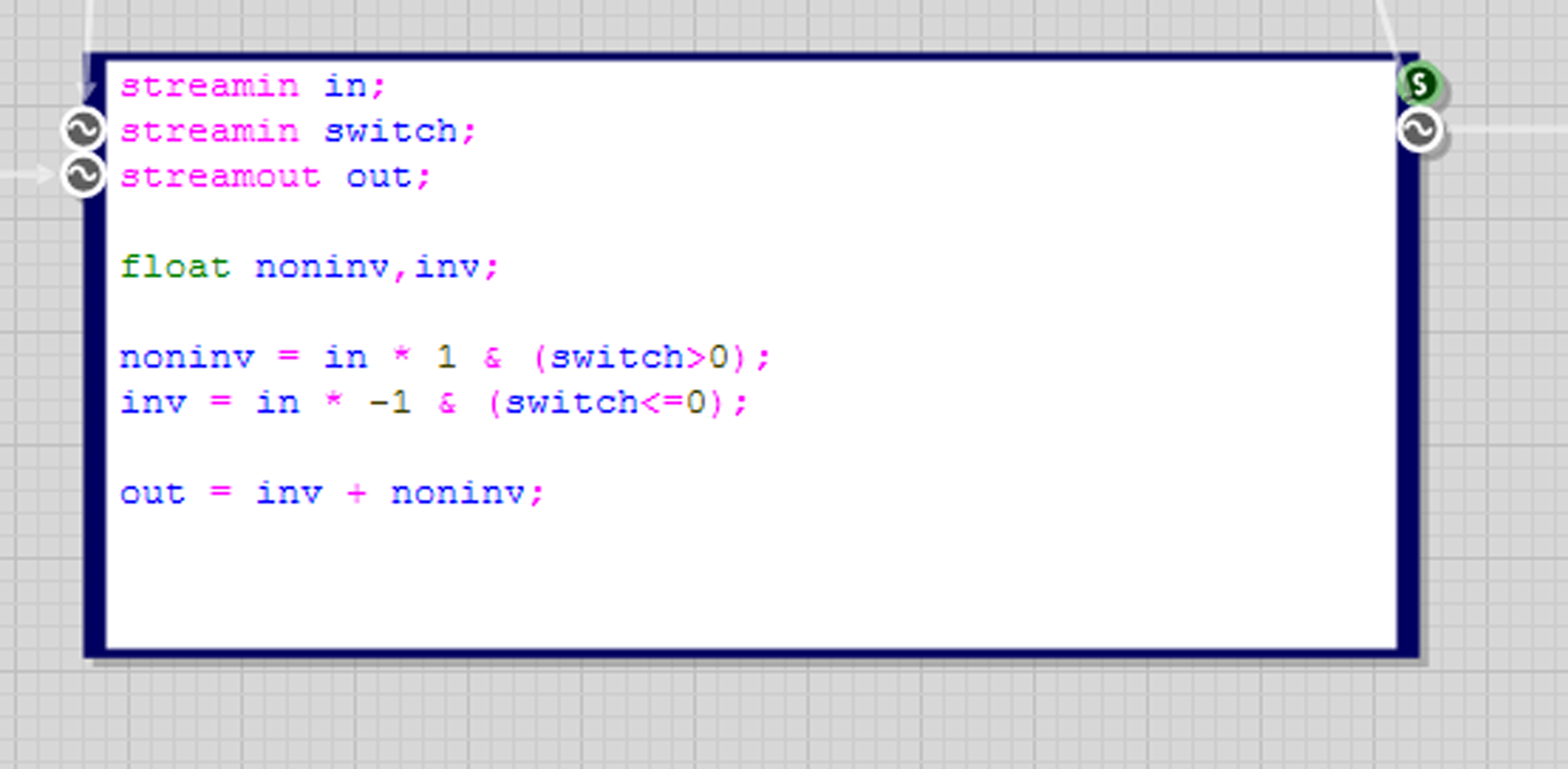

Here's a poly stream-controlled inverter I knocked up, together with a demo test synth attached.
I wonder if this could be made more efficiently in DSP code...
Stream controlled inverter -Spogg .fsm- (552.05 KiB) Downloaded 1095 times

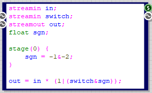

Hey Spogg,
thanks for participating! Interesting question. I came to the conclusion that basically you only care for a sign switch (positive switch input = +1, negative switch input = -1). I always look at all modules, Martin shares with us. In the past, it didn't help me the slightest bit. But now that I slowly start to understand the dsp editor, I remembered that I once saw a sign bitmask in some of Martin's modules.
I have no clue what exactly is happening to the bits, but I know what a sign function does in higher level programming languages. And since it is a bitmask, I knew I had to somehow bitwise combine it with the switch. After several tries, I came up with this
The final code then looks like so:
What do you think? And what do the DSP gurus think?
sgn = -1&-2 //sign bitmask defined in stage 0
1|(switch&sgn) //results in either -1 or 1
Stream controlled inverter -Spogg(tula) .fsm- (86.11 KiB) Downloaded 1109 times

Yup, tula's inverter does the same as Spogg's and is more efficient.
It is probably not meant to be used as in the schematic because it aliases quite heavily.

Re: tula's DSP modules
tulamide wrote:
sgn = -1&-2
There is actually an even simpler method to get a sign mask in dsp code:
float signbit = -0;
Unfortunately you can not use xor in dsp code, otherwise one could simplify the code to
out = in ^ (switch & signbit);
This is why I don't like the dsp code module, it is limiting because it doesn't have all the features and the generated asm code is poor.
TheOm wrote:There is actually an even simpler method to get a sign mask in dsp code:
float signbit = -0;
Cool!
Do you happen to have a simpler expression for the abs bitmask as well?
martinvicanek wrote:Do you happen to have a simpler expression for the abs bitmask as well?
No, unfortunately not without using stage0. I don't think there's a way to type NaN in the code module, is there?
- TheOm
- Posts: 103
Assuming the ^ symbol means XOR it'll be available in the 3.09 release according to the list I have. The DSP code will be extended considerably.
