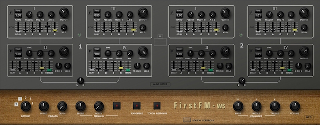

I think I like this better -
I've never really enjoyed building waveforms with additive oscillators, but I'm very much intrigued with the core concept of the Synclavier's FM engine: two-op FM with the carrier capable being a sine or more complex shapes.
So, this version has Martin's WaveShape oscs for the carriers in place of the additive, and for good measure, the modulators are now Martin's Spread Partials oscs. Since both can generate pure sine, it can still be used in original GS1 fashion.
It's Vicanek squared! (I've given him credit on the front panel).
I've included a button in the carriers to direct the modulators directly to the audio out, so one can have a great deal of 'FM' colors to play with without doing any actual FM programming.
Most of the presets are carried over from SkematicGS (sine on modulators and carriers), but they sound a little different because this one has no feedback. Having all those waveform options in both the modulators and carriers makes it a little less neccessary. It's interesting to hear the changes in the sine-only presets by moving modulator and/or carrier off from sine.

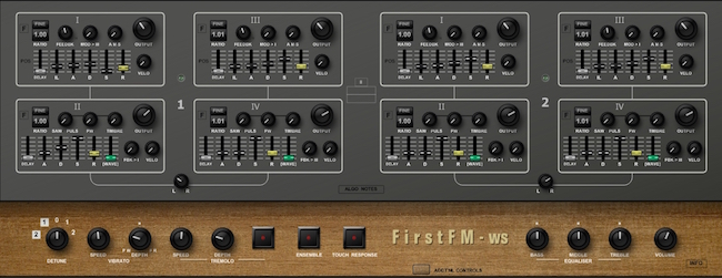

To retain the full compliment of feedback, and the GS1's Modulator cross-mods, this version keeps the Modulators sine, but still has the WaveShape oscillators in the Carriers instead of additive ones.
This probably the best of both worlds?

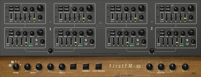

Re: Yamaha GS1-inspired synth, revisited.
A better best.
Reading about Tone2's Nemesis (Lord I'm sick of everything in the non-Classical music world having to have ugly/dangerous/painful/evil names, that most of the time don't even make sense in the context - what would 'Nemesis' possibly be a "nemesis" for/to?) "Neo FM" engine, I had to give a nod the great ideas therein.
So, the controls to change the Carriers' waves from sine to complex have been changed to incorporate some of the main 'Neo FM' functions. Rather than crossfade Saw > Pulse, with a seperate Timbre control, one knobs morphs sine-to-saw turned CCW, and sine-to-square turned CW (this roughly approximates the Neo FM 'filters'). The resulting timbre can be modulated by the carrier's EG. A Mix control that crossfades between the timbre created by the FM from the Modulator to the un-modulated wave created by the Carrier's Saw-SIne-Squ control (this turns out to be more useful than it might seem at first). A Phase control than shifts the phase between the modulator and the carrier (I'd done this in my Buchla emulations, but had forgotten how useful it is in fattening some FM sounds). And lastly a sine mixer that mixes in an un-modulted sine wave at the pitch of either the Carrier or the Modulator (especially useful when the Carrier is at significantly higher frequency than the Modulator, which sounds like a high pass filter).
These controls provide for a wider and more useful range of Carrier waveforms than what I'd originally done, while still utilizing Martin's wonderful WaveShape oscillators.
I'm starting on a piece that will include most of the 'Neo FM' features (complex oscs for modulator and carrier, full synth controls, a mod matrix, etc,). Using the GUI style I used for my version of the Trautonium-inspired projects that Spogg and I collaborated on (he did all hard stuff
) His is called 'Trout', and is a way more complex and complete Trautonium emulation: viewtopic.php?f=3&t=58028&p=170078&hilit=Trout#p170078
