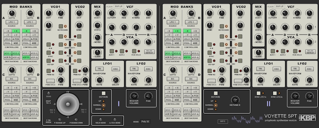

I'm thinking of trying to make some of the text on Voyette a bit larger - is anyone having trouble reading any of it? I think most of you have larger displays than I do.

k brown wrote:I'm thinking of trying to make some of the text on Voyette a bit larger - is anyone having trouble reading any of it?
It's fine for me, and I reckon it scales well with the front panel controls.

A pretty major (for some people) feature added - the joystick now accepts MIDI CC# 16 for X and 17 for Y, so it can be controlled with Yamaha SY22, SY35, and TG33; or any midi joystick with programmable CC outputs. This thing would be far more fun to play with an actual, physical joystick, and if it's a spring-to-center type it would be just like playing the Voetra's companion keyboard.
Also a few other tweaks and corrections.

Just added a couple key features that I overlooked - since this mostly emulates the Voyetra Eight's 'Layer' mode (a left/right pair of poly voices), the V-8's joystick output could be inverted for the left voice (the hardware had one voice panned hard left, the other hard right; here each has a pan control, so in the plugin, it's voice 'I' that has it's joystick output inverted). The hardware would only invert the X output because the Y was hardwired to pitch only, and not available in the Mod Banks. Here, the Y output can be disconnected from pitch and is available in the Mod Banks, and the X and Y outputs can be independently inverted to 'voice' 1's Banks.
Also, when in 'Layer' mode the V-8's right voice's LFO rate controls are synced to the left voice. So added buttons in 'voice' II to sync each of it's LFOs' rates to those in 'voice' I.
