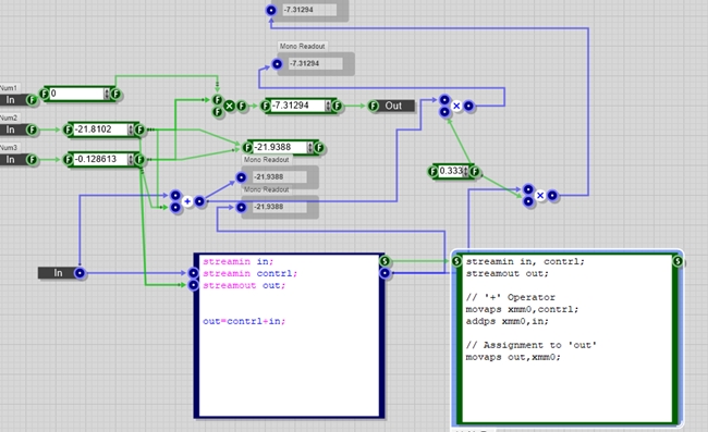

Postby lalalandsynth » Tue May 28, 2019 9:30 pm
You are being too defensive in my opinion , the plugin will not render correctly, That is hardly what you are aiming for. People will not love that !? And the plugin will not always sound the same , people will not love that and unless you disagree that it will not sound or render correctly I cannot understand why you are being defensive?
it could also cause the user some headaches as one would never expect it not to work the same when rendering
You can fix this pretty easily as far as I can tell , you can add the floats to the stream like this.
streamin in, contrl;
streamout out;
// '+' Operator
movaps xmm0,contrl;
addps xmm0,in;
// Assignment to 'out'
movaps out,xmm0;
or just use a stream add ? unless I am missing something ?
And then just use a multiply stream for the 0.33 mult.
Same result , just sample accurate, apart from the rest of the circuit. ...

I am not discussing the validity of the approach , i.e using a leveler rather then a limiter, that is fine.
I dont know if you are just ignoring what I am saying but I will say it again, when you do a faster then realtime render in Reaper for example, which I do all the time , the plugin will not behave in the same way , i.e the rendered file will not level out in the same way as what you hear when playing.
I find it hard to believe that you find that acceptable ?
