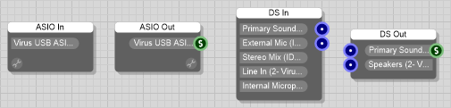

Postby nix » Sat Apr 26, 2014 2:47 am
Here are the dialogs on my internet machine.
My other system has 3 ASIO soundcards installed,
so the selection would be randomly one of those.
Yes, leaving audio on can cause problems for sure.
It will just turn on a random configuration.
nix
