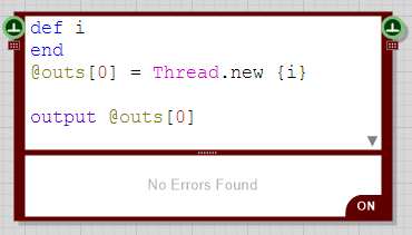

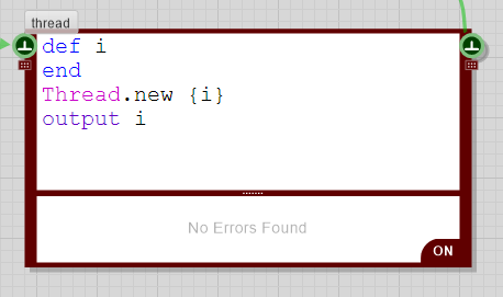

little update.
This ruby threading method works!
Here is the working codebox->
Here is a modified dropdown->
Cooool!
Cooool!

Your "thread" is to prevent loop repeating right?
If so then this doesn't work on any of the midi keyboards I currently have, the looped audio still remains.
So far the new ruby selector and routing matrix (with a little connection fix) works fine with no problems.
I'm near enough finished with the preset manager too, as soon as I have finished them I will upload them all in one schematic.
