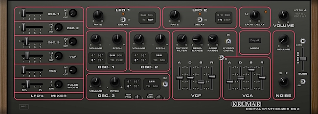

Inspired by some of your comments in the minDy thread that sometimes a limited synth can inspire, and as regards emulations especially - there's value in resisting the temptation to pile on extra features and capabilities. So I did a version of the DS-3 that has most of the limitations of the hardware (except for re-jiggering the Poly section as a third multiwave oscillator).
Krumar DS-3_os ('os' for Old School)

And, shamed me into giving it a couple more presets than the original version.

I had no intention of shaming you Kevin! That would be awful.
I do think you know that I was actually intending to encourage you!
Anyway, this last version is great and those extra presets are exactly what I was going on about. And I love their names too.
Thank you!
