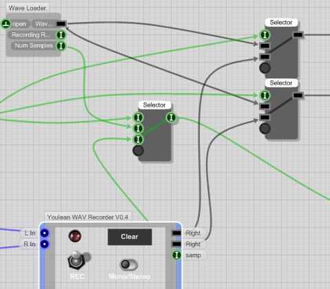

I need stereo-sound, and it must be very simple, to save the recorded file as stereo and get it as a stereo array back in flowstone, because I want to switch between recorded and prerecorded material in the scratcher... I posted the "scratch" project in another thread.
1000 Thanks
Martin
1000 Thanks
Martin

Re: Unlimited Size WAV Record V0.4
Hey Youlean.
I'm glad that I found your module, however there are few problems to address.
Memory usage. Recording 15 minutes of audio (44.1k/stereo) produces about 600MB of memory usage. This is probably due to the green coversion on output (arrays of floats).
When recording stereo, channels are sent to output separately as arrays of floats. Converting this to single output file would require interweaving in greens (or whatever else in greens), which would produce additional usage.
Do you know any workaround for these issues?
The best way would be to have mono and stereo mem outputs, so that mem data are sent directly to saving or else, but from what I see - this dll prim does not supports such nodes.
So maybe there is some way through these red V (for ruby?) nodes and ruby?
